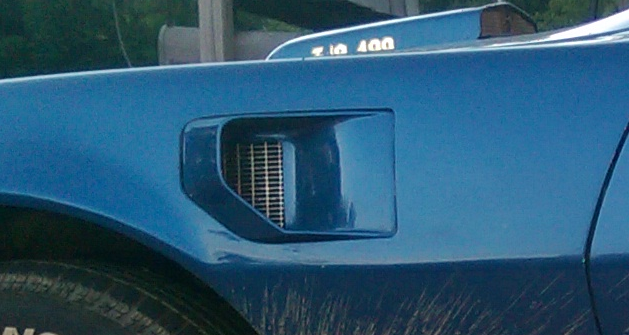

I also did the side gills on fenders...
I also did approx three coats each...side that was one coat at that time...
