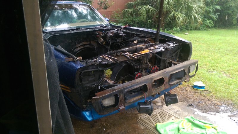

And while we are at it Ill cover a couple things all kinda related to engine pulling your hood is off you may as well take the nose off and do headlights or whatever you feel the need to get done while everything else is out of your way...
Also adding Driving Aux lights Underglows or rock lights...
Sand Blast the engine bay and paint again with like 12 cans of rattle Black gloss...
lol
Dont forget to re install the rubber section for the nose support Like I did once...

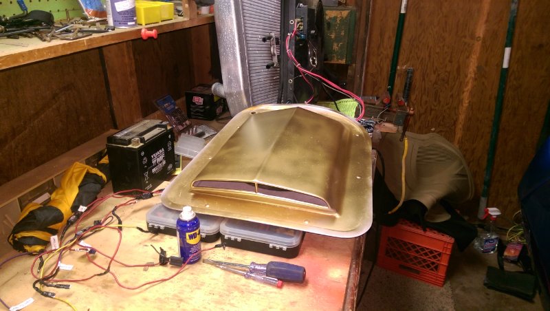

So since the 79 and 77 shaker are different as you can see the 77 sat thinner and lower but since it will be mounted to the hood anyway a sleeker look to me will be nice also the engine still fits the hood the same... The air filter now a full air flow draws from all sides including the top itself...
So I switched shakers painted it then decided I didnt like the gold and the clear coats keep messing up the paint would look cracked so I said screw it went black and mounted it with electronics for the installed shaker back light then sealed it to the hood... if you notice you see the brown liquid nails and a void gap like I was attenmpting to explain...  first pic below here...

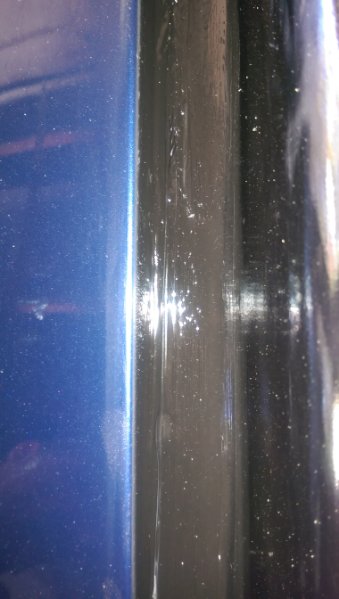

Then you notice down here at the bottom the mirrors look cut in and filled a lot better...
also I trimmed the mirrors in painters tape all along the edge line and then I painted Jet Gloss black... all over the transition from hood to seal to part...
shaker whatever...cross brace...
then when I peeled the painters tape this left me with a preitine edge and all on the actual reflective surface of the mirrors by using the glas the lines are crisper and cleaner and the tape removal went like a snap...
