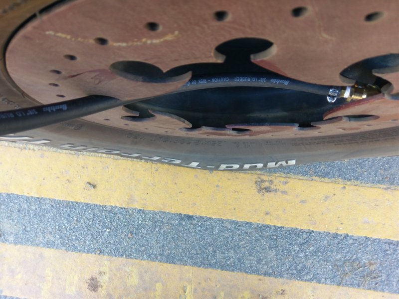

On board Air pump system... all tires simultaneously...
Your price is going to be higher...
First off get a weather proof hose not the cheap one I bought they will dry rott on you in less than a yr... Trust me...
The rest actually all worked great pump did get really hot so keep that in mind but I find it works about the same as having a dual cylinder pump in the back of the jeep and doing the tires one at a time deflate was perfect since the pressure was exactly equal in each of the four tires filling up also again dead nutts... but took a minute or two and I prefer to let the pump cool down a bit so there is a lot of dead time...
I vcan reuse everyone of the connections also make sure to buy the best clip on valve stem connections that spring load into position not clamp they suck...
